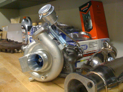

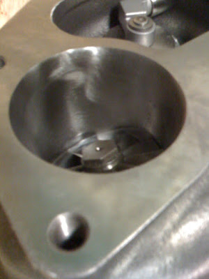

Welcome to my complete review of the BBK Full Turbocharger. I’ve seen many people dying for some reviews and results so I won’t skimp out. Hope you ‘re ready for a novel and some real deal results, comparisons against the stock turbo, HTA30R, dyno graphs and track times. Please ask any questions you have, I will be watching this thread.
Pre-Purchase- After selling off my AMS turbo kit, I knew I wanted something that spooled just like the stock turbo but also could produce much more power. I was trying to build a better balanced street machine and that’s exactly what I got. Not willing to deal with the wait for the red or the customer service issues with FP, I had confidence that the BBK would be an excellent turbo for my application.
Product Purchase – Chad was great throughout the whole process. I had a lot of questions which were all answered in a timely and professional manner. I had the BBK in my hands within 5 days of ordering it which was amazing. The porting was very nicely done, the core looked perfect, oh, and the billet blue wheel looks pretty cool too!
Install – Easy squeezey, stock housing turbo = no problems at all
